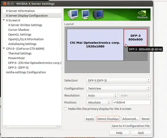

Anyways, the monitor works beautifully with my Ubuntu desktop which has an nVidia card with DVI output. However, I am having problem using this monitor with my laptop. After some searching around I found a few posts suggesting to use an active adaptor for mini display port, so I went and bought a mini display to dual link DVI-D adaptor.. When using this adaptor the monitor is recognized by nvidia-settings tool but with incorrect resolution information.
As you can see the monitor is incorrectly recognized and there are no other resolution available to set. This post on ubuntu forums and this other post on overclock both suggest that the monitor is reporting corrupt EDID file. I have tried following their instructions, but so far I have not been able to display any image on the monitor from my laptop.
