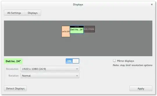

Use the Displays application to arrange the monitors as you wish (I have one side monitor rotated counterclockwise). arrange your monitors as you wish
Once you press Apply, a new monitors.xml is created.

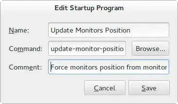

If you want this to be automatic, simply add a startup application, with the following entries:
  • Name: Update Monitors Position
  • Command: update-monitor-position 5
  • Comment: Force monitors position 5 seconds after login
