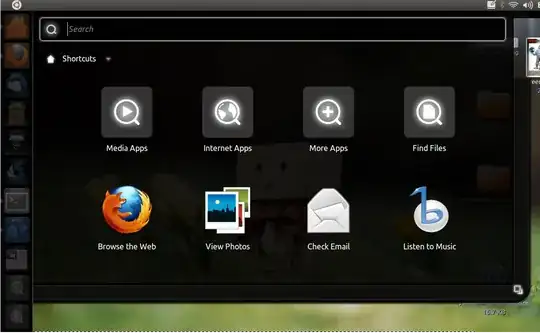

Unity Dash
From 11.04 to 17.04 (Unity), Ubuntu had an even better solution built in: The Dash!
screenshot
With the dash you can do all kind of cool stuff, such as:
  • Search through your files
  • Find installed and available applications
  • Run commands
  • There will be many more features in the future, as the dash is extendible through so called "lenses". These will allow you, for example, search Ask Ubuntu right from your desktop.
Just hit Super to open it in 11.04!
For more information, check out this link.

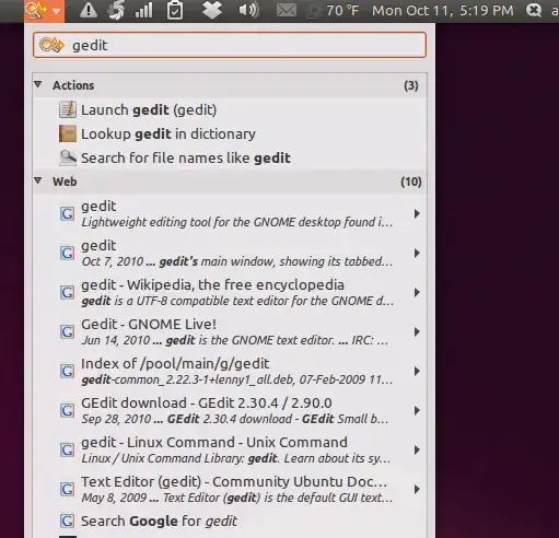

Deskbar
Deskbar is probably the closest application, as far as the user interface goes, to spotlight.
Click here to install.
deskbar
It has a number of backends, allowing you to search for files, launch applications, search the web, and a lot more.

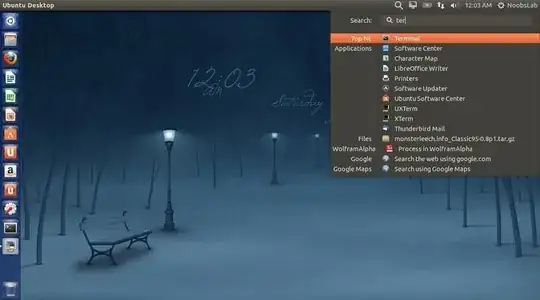

I found a search indicator similiar to Mac Spotlight, name is Indicator Synapse. I copied quote from noobslab.com
It creates virtual index of files and items which are on the system. It is designed to access files and items quickly. It also has ability to search in online dictionary/knowledge engine (WolframAlpha) and web.
Indicator Synapse It only works with Unity Ubuntu 12.04/12.10/13.04/13.10 and Gnome Classic
To install Indicator Synapse, open Terminal by press Ctrl + Alt + T and copy the following commands to terminal
sudo add-apt-repository ppa:noobslab/apps
sudo apt-get update
sudo apt-get install indicator-synapse
After installation is finished, log out and log in back to see indicator synapse on the panel
