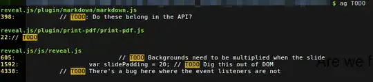

The Silver Searcher
A code searching tool similar to ack, with a focus on speed.
screenshot
