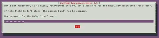

  1. Start the reconfiguration with:
    sudo dpkg-reconfigure mysql-server-X.X
This will prompt you to enter your new password and confirm the reconfiguration.
snap1
  1. Now you can log in :
