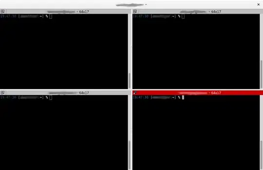

You need Terminator:
sudo apt-get install terminator
Terminator 4 windows
For four terminals at start-up, do the following:
  • Start terminator
  • Split the terminal Ctrl+Shift+O
  • Split the upper terminal Ctrl+Shift+O
  • Split the lower terminal Ctrl+Shift+O
  • Open Preferences and select Layouts
  • Click Add and enter a usefull layout name and Enter
  • Close Preferences and Terminator
  • Open Terminator with this command:
    terminator --maximise --layout=<your_layout_name>
    terminator --maximise --borderless --layout=<your_layout_name>
Jump between the terminal windows with Ctrl+Tab.
You can assign your personal terminator command to Ctrl+Alt+T in Keyboard Settings > Shortcuts. (Thx @Wilf)

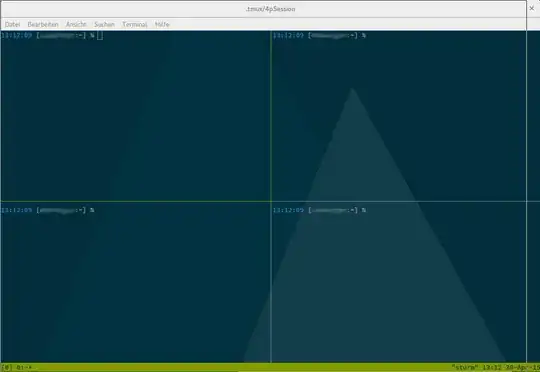

You can use tmux, a terminal multiplexer.
sudo apt-get install tmux
For four panels you can use this script 4pSession, create the script with
mkdir -p ~/bin
touch ~/bin/4pSession
chmod +x ~/bin/4pSession
nano ~/bin/4pSession
and add the code below
#!/usr/bin/env bash
# if the session is already running, just attach to it.
tmux has-session -t 4panel
if [ $? -eq 0 ]; then
  sleep 1
  tmux attach -t 4panel
else
  tmux new-session -d -s 4panel
  tmux split-window -v
  tmux split-window -h
  tmux select-pane -t 0
  tmux -2 attach-session -d
fi
Than you can create a desktop file:
nano ~/.local/share/applications/tmux.desktop
with this content:
[Desktop Entry]
Name=tmux
Comment=a terminal multiplexer
Exec=/<path_to_script>/4pSession
Icon=terminal
Terminal=true
Type=Application
Categories=Terminal;
Move between the panes with Ctrl+B and than or or or

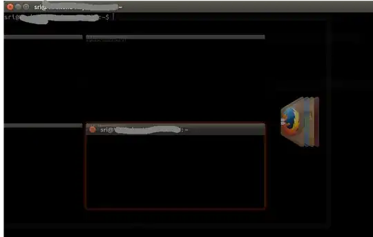

Sri
  • 1,743
you can use the application "screen"
Install screen by running the following command:
apt-get install screen
To verify that screen has been installed, run
screen -v
within a screen session, you can create a new window by pressing CTRL + A, then C. Your old window will remain active and you can perform other tasks. To switch between windows, press CTRL + A, then N (for the next window) or CTRL + A, then P
