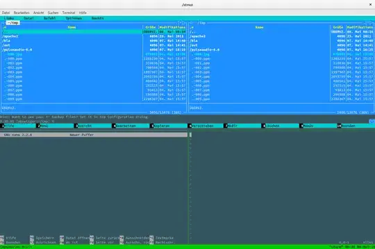

You could use tmux. Here I describe how to start tmux with four panels.
In your case, you could use and adapt this script.
#!/bin/bash
session="mysession"
if tmux has-session -t "$session"; then
  "Session $SESSION already exists."
  exit 0
fi
# start ./startProgram1 here
tmux new-session -d -s "$session" mc
# start all other applications
# use -v for vertical split and -h for horizontal
tmux select-window -t "$session":0
# start ./startProgram2 here
tmux split-window -v nano
# start ./startProgram3 here
tmux split-window -h vi
tmux attach -t "$session"
The current behavior is
A.B.
