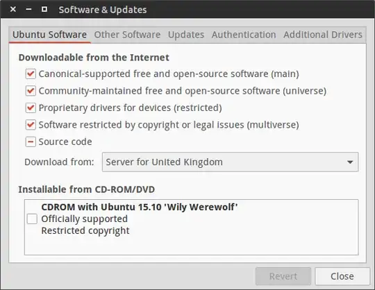

If you don't see the driver you want listed then you may need to allow more software sources. Click on the Ubuntu Software tab and check the 4 checkboxes like this:
Ubuntu Software
