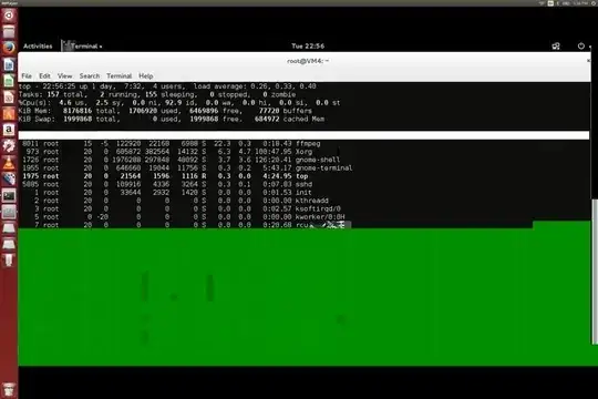

Using vaapi driver to decode and play h264 stream, mplayer shows artifacts about once every 5 to 10 sec, as a partially "green frame" (frame with a green stripe across it, of varying height, sometimes most of the frame, sometimes much less).

Image displaying artifacts:

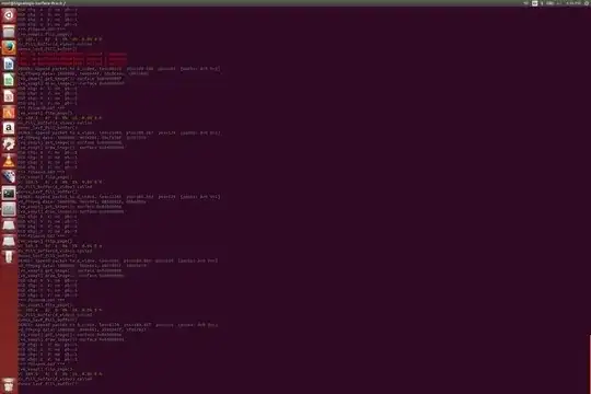

Image displaying error messages:
