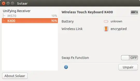

I got to this page as I was trying to find a way to keep function keys as normal (and not their K400/r special functions which works in windows). Finally found it in Solaar, which has a "Swap Fx function" which should be turned to OFF
