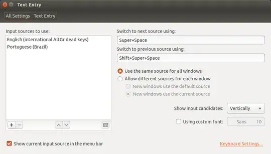

(Here is a screenshot of my Text Entry settings. The keyboard settings leads to other panel that only allows to set up key bindings. There is no Options button.)
My Text Entry settings

I'm running Trusty, and found the place to set the Compose key right where David suggested: in Settings/"Text Entry"/"Keyboard Settings...."/"Text Entry"/Shortcuts/Typing (where the selections are a confusing mix of menu selections, tabs, highlighted text, selections from a list, etc). Note that is the same settings dialog that you can get via Setting/Keyboard/Shortcuts/Typing. A bit confusing....
Then I set Compose Key to "Right Alt", and now I can press "Right Alt" then shift "6" (for the "^" circumflex), then "c" and get ĉ :)
