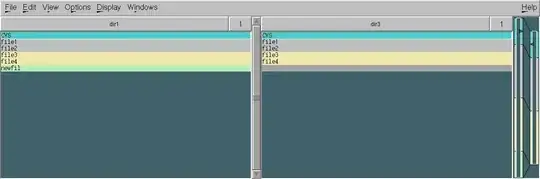

xxdiff is unmatched if you just need to graphically see the changes between two files (or directories!):
Like regular diff and comm, your input files should be sorted first.
sort file1.txt > file1.txt.sorted
sort file2.txt > file2.txt.sorted
xxdiff file1.txt.sorted file2.txt.sorted
