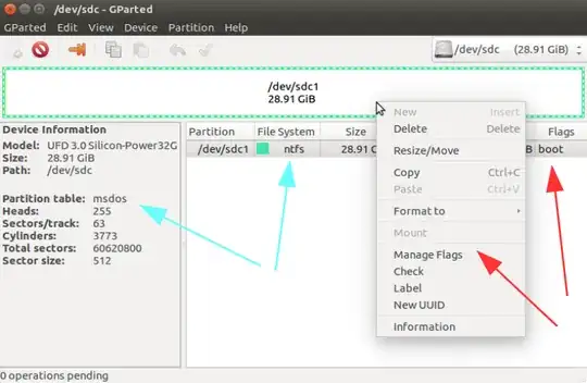

  • format your USB to FAT32 with MSDOS partition table and mount USB (as shown on picture in 1.3. No need to adjust the flags.)

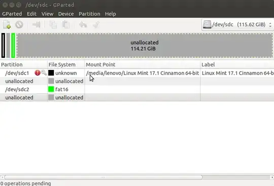

The only drawback is after this procedure USB will have messy file system, so you have to correct it afterwards. It will create a bootable USB no doubt, but it need to be formated for further use. enter image description here
After you're done with your OS installation and you would like to use your USB for something else then do this:
-select sdc1 (black field) and unmount. Ignore the errors (GParted can't read filesystem properly).
-change partition table (e. g. back to msdos)
-open view/device information to see if it has been changed, if not simply repeat once again
-format (e. g. FAT 32).

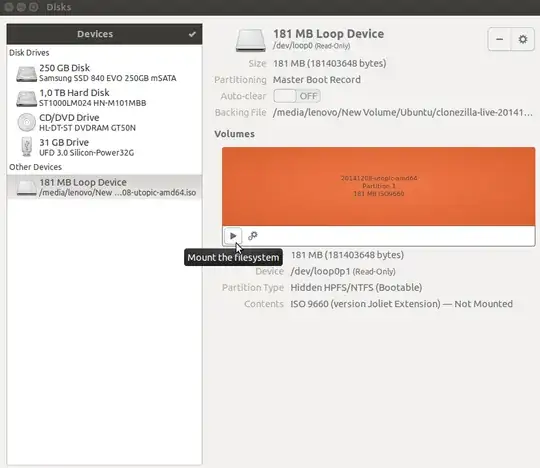

To install Clonezilla do not use Disk image writer:
-format your USB to FAT32 with MSDOS partition table
-right clik on image and select open with/Disk image mounter. You're image might not be visible in nautilus. Open Disks and mount it hitting play. enter image description here
-simply copy paste all files from ISO drive to USB (don't forget to pres CTRL+H for hidden files)
-in Gparted manage flags and select boot (as shown on the picture in 1.3.).

But actually, the GUI based solution would be interesting. It requires, ironically, Unetbootin. That's right, all you need to do is to trick Unetbootin to install Windows ISO by changing the file system. I have tested it with Windows 7 x64.
This is the procedure:
  • format your USB to FAT32 and mount
  • open UNetbootin and prepare it to write, just before the installation, but don't install the ISO yet just leave it open
  • format your USB to NTFS, check if it has a boot flag in Gparted and mount USB enter image description here
  • switch back to Unetbootin and press OK.

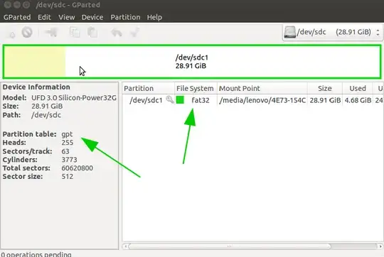

This should be a very easy task and ordinary issues occur due to poorly formated USB drive (it should look like this picture), but unfortunately the recommended solution - Startup disk creator failed for me in Ubuntu 14.10. Nevertheless, basically what you should do is this:
  • create FAT32 formated USB with GPT partition table
  • copy all the files (including hidden) from ISO to USB.

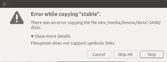

While this solution worked like a charm for Linux Mint, Clonezilla (read about mount problem in 1.2.) and Windows 8 copying files from Ubuntu and Kubuntu mounted ISO reported problems with symbolic links. Now, I have installed my Ubuntu using this method and have been using it for past 5 months.It is convenient because it is easy to set persistence. But you can play safe and use Disk image writer I already explained in 1.2. Of course your USB drive have to be formated GPT FAT32, as I already explained, but when Disk image writer finish it will have structure like on 1.2. picture.
