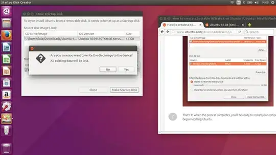

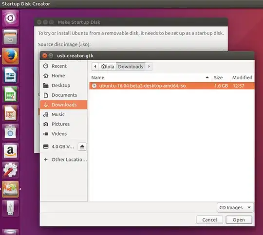

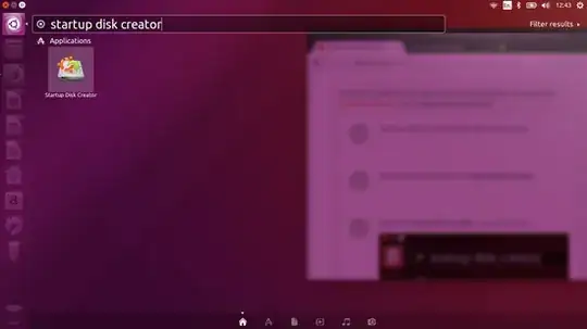

Startup Disk Creator (Click here to see original version)
  1. Insert a USB stick of appropriate capacity
  2. Open the dash and search for Startup Disk Creator
  3. Select the Startup Disk Creator to launch the app
  1. Click 'Other' to choose the downloaded ISO file if it isn’t found automatically, select the file and click 'Open'. Select the ISO
5.Select the USB stick in the bottom box and click 'Make Startup Disk' and then 'Yes' enter image description here
  1. Allow process to complete and test.
If you are successful with this process, then please provide feedback by upvoting. Best of luck!

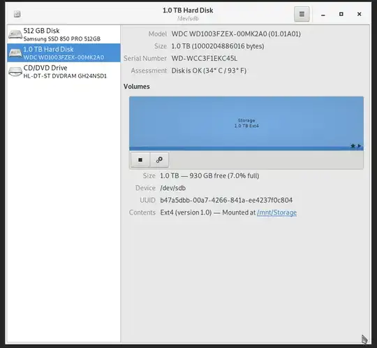

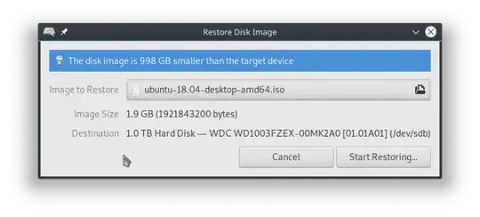

I find using Ubuntu's (and not only) built-in tool, called gnome-disk-utility, to be the most convenient way to make a bootable USB stick.
Open it and from the list on the left side select the device that you'd like to put the iso on (supposedly a USB stick).
After that, click on the two gear icons and select "Restore Partition Image...".
Navigate to the target ISO file and select it. Then press "Start Restoring...".
It will ask you for your password and additional confirmation before it actually starts transferring the file.

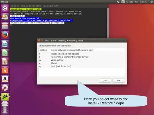

The main task of mkusb is to wrap a safety belt around the cloning tool dd.
mkusb works in and with all current versions and flavours of Ubuntu. It works also in and with several other linux distros, and can create boot drives with Windows 7-10. (Creating persistent live drives is limited to Ubuntu, Debian Jessie and distros with the same boot structure.)
The classic mkusb version 11 has many features and is polished and debugged. The next/new mkusb version 12 (alias dus with the graphical user interface guidus) has a simplified user interface, that is very easy to use. It is getting ready to become the default version very soon, after a period of testing and debugging.
See these links for more details,
