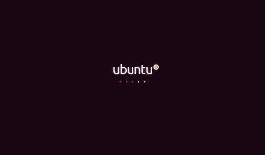

When I installed KDE, the original Ubuntu's splash screen:
mutated to an ugly screen where I could read "Kubuntu 14.04" with red little pixels.
I have been able to remove that screen following the answers of the questions I linked above. But as a result, I have no splash screen, it goes black with a _ blinking in the upper left corner until the login screen appears.

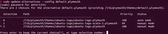

As I said before, I have already tried the solutions of these other answers, including
sudo update-alternatives --config default.plymouth
which let's me choose between 2 options (one of them apparently duplicated): plymouth, but none works. Also
