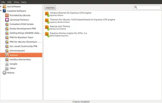

24
Expand the "Installed Software" item in Ubuntu Software Center. You'll see a list of all the different repositories that you've enabled. Clicking on the repo will show you the packages you've installed from each.
alt text
