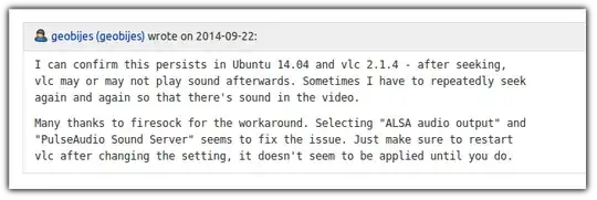

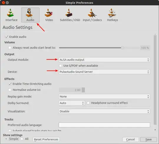

After some googling I found this bug report on launchpad in which someone posted a "workaround" that is working for me.
Configured VLC with the settings below by going to Tools->preferencs.
Then click save and close all VLC instances before re-launching your video. Now you can seek without ever losing audio.

Go to tools preferences audio and then set the output to ALSA audio output then a new option labeled device pops up set it "PulseAudio sound server" or "playback/recording through the PulseAudio sound server". Restart vlc test it out
