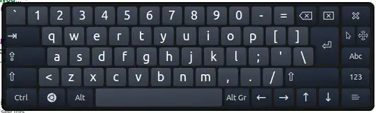

I have tried 'onboard' also. When I press keys on it using mouse nothing happening. So I think issue is related to OS only.

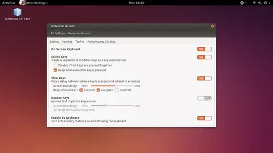

I fixed the issue. Somehow the Slow Keys option from System Settings → Universal Access → Typing was on. Thanks to this question's accepted answer.

Now ensure that the problem is not with OS and it is because of the hardware. For this you can use the onboard utility comes with ubuntu. It might look like this.enter image description here
Verify that all the keystrokes are accepted by the OS properly.

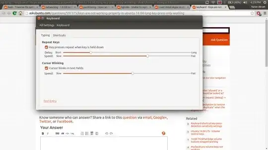

Open keyboard setting by searching keyboard in dash
Click on keyboard
Check both checkboxes and decrease delay and increase speed.
