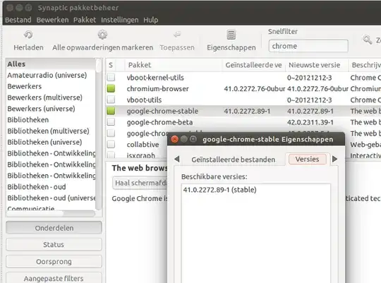

If you want to keep- or revert to an older version of your software, the most convenient way is to use Synaptic Package manager:
sudo apt-get install synaptic
Once installed, open Synaptic, look up Google Chrome, select it and choose from the menu: "Package" > "Properties", choose the "Versions" tab. Here you can see what versions are available. In my case, that is only the version you do not want (since I run 14.04, If I remember well you run 12.04):
In your case, the earlier version will be listed as well, I will use the example on Firefox here to show how to return to an earlier version:
  • Select your package form the list
  • Choose from the menu: "Package" > "Force Version"
  • Choose your preferred version:
    Apply the changes
  • To make sure the package will not be updated, choose from the menu: "Package" > "Lock version":
More information on how to keep- or revert to previous packages can be found here.
