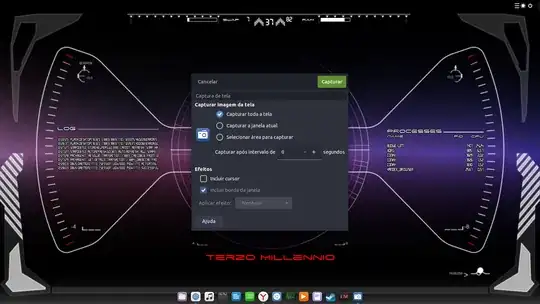

enter image description hereSuddenly my taskbar have a bug when I start my computer!I remember that I did updates at last time that I used Budgie working good.However,it isn't possible to find a start menu and clock on my top taskbar.I tried some commands like sudo apt-get update sudo apt-get install gnome sudo apt-get install budgie-desktop but nothing happens!I would like if someone helps me...Thanks.

It looks like a bum update. Install Synaptic package manager with sudo apt install synaptic and undo the latest software update with Is there a way to undo software updates?, then use apt-mark hold <package-name> to prevent the same update from coming back again.
To restart the Budgie top panel run the following command:
nohup budgie-panel --replace&
To reset the entire Budgie top panel back to its default settings run the following commands:
budgie-panel --replace --reset # afterwards press Enter, then press Ctrl+C
