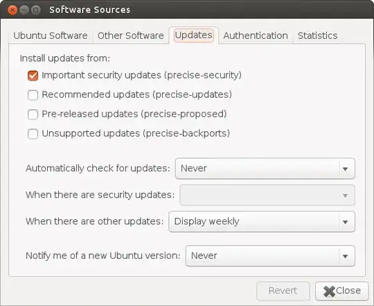

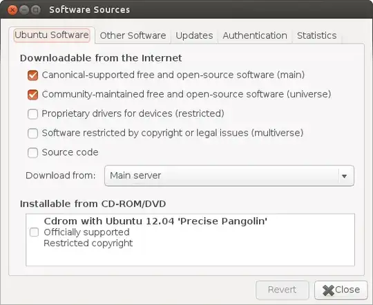

Select Software Repositories
sudo software-properties-gtk
Update repositories
sudo apt-get update; sudo apt-get upgrade
