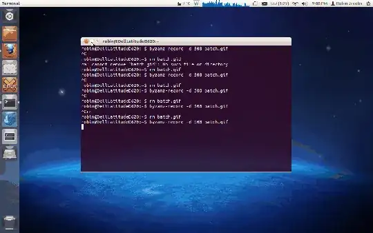

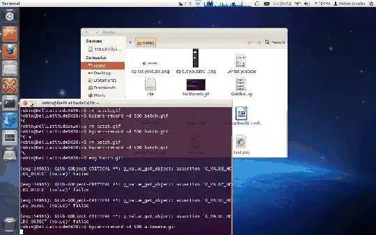

Open your text editor, and type the following line: #! /bin/bash. Leave an empty line and start typing your commands. Save the file, the extension doesn't matter. Go to the file in your file manager, right-click it, open the properties dialog, go to the permissions tab in the dialog, check the "Allow execution of this file", and click the close button. Now you can double-click the file and choose to run it in a terminal window.
