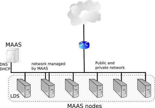

Flat network
The flat network model is the most basic one. Here we trick the system and simply say the public and private networks are the same and connect both NICs to it:
Flat network
OpenStack floating IPs will come from the same network as MAAS node IPs in this scenario.

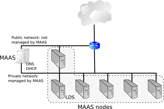

Split network
In the split network topology, we have two actual distinct networks:
Split network
MAAS only manages the private network, for which it will setup DNS and DHCP, but it has to know about the public one. An easy way to handle that automatically is to just hook up a second NIC to the MAAS machine and connect it to the public network as shown. MAAS will then automatically know about it.
