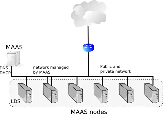

Have only one network, and plug all NICs to it. For the VM that has two NICs, plug both of them to the same network. Like in this image:
AutoPilot flat network
You can see that one node has both NICs connected to the same network. Delete all your MAAS nodes and enlist them again in this configuration.
