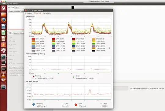

I installed Ubuntu 12.04.5 (64 bit) on a Dell T5500 with two Xeon 5650 6-core processors specifically to run the free DCP-o-matic software (http://dcpomatic.com/). The same machine used all 24 virtual cores before under Windows 7 Professional 64 bit, but I was just not happy with that OS.
Under Ubuntu the performance was less than 1/10 of what I had experienced under Windows. I next upgraded to 14.04.2 but to no avail. Monitoring the resources makes it clear that the processors are throttled down after reaching their peak performance. The pattern looks like saw teeth.
Here is a screenshot screenshot
What can I do to achieve maximum performance? Any help is very much appreciated!

It is more likely then not due to CPU scaling.
See https://wiki.archlinux.org/index.php/CPU_frequency_scaling
CPU frequency scaling for 12.04?
https://wiki.debian.org/HowTo/CpuFrequencyScaling
You can set your governer to performance
GOVERNOR="performance"
http://www.servernoobs.com/avoiding-cpu-speed-scaling-in-modern-linux-distributions-running-cpu-at-full-speed-tips/
Personally I would set it back to ondemand once you are done using it
