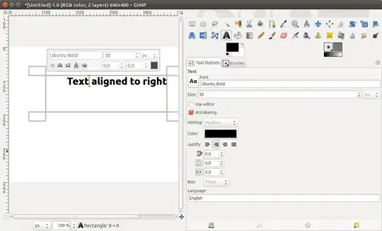

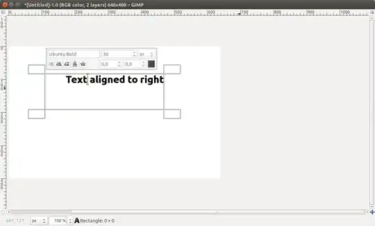

Gimp has a feature to run in single window mode, or to run in classic mode where tools and docks are displayed as their own window. To toggle between these modes we tick or untick Windows > Single-Windws-Mode from the global menu top bar.
Single Window Mode

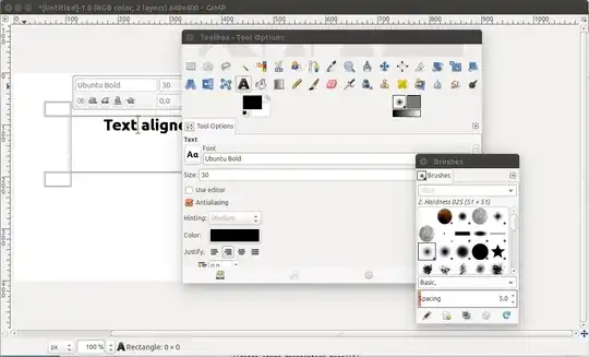

Classic Windowed Mode
In windowed mode we can close all windows. They will then disappear and will no longer be available until we re-open them. These windows also will not re-appear on just toggling to Single-Window-Mode.

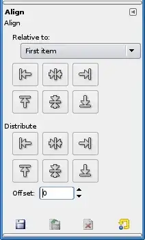

This is what we are looking for:
GIMP Align tool options
If this docked dialog is missing, it is easy to get it back by following this menu path: Windows → Dockable Windows → Tool Options
