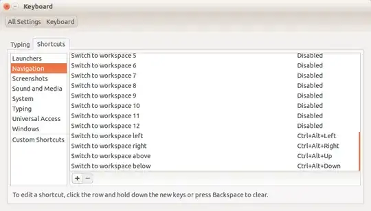

Ubuntu 14.04. The shortcuts Ctrl+Alt+ and Ctrl+Alt+Shift+ to change workspace and move applications do not work.
Here is the image of the shortcuts configuration enter image description here

Other Ctrl+Alt shortcuts (like T to open the terminal and H to open the home) work fine.
I already tried to re-set them with no luck.
Any hint on how to solve the problem and being able to use them?

For the shortcuts to work you need at the minimum the workspaces setting enabled:
Settings - appearance - behaviour tab and tick the workspaces checkbox
Assuming that this is correct, the next step is to confirm if this is account specific or system wide. Login to another account to confirm.
If you dont have access to another account, then look at account specific stuff.
You could try resetting Unity as per our canonical Q&A:
If this still doesn't work, then you can use the ultimate "correct everything" method of clearing down all Gnome settings:
