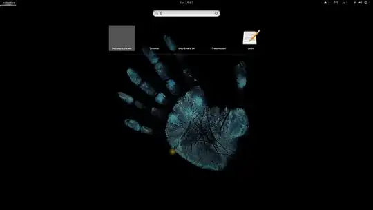

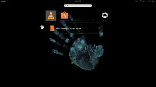

The current problem has happened to me for the second time (last time I reinstalled whole Ubuntu to solve it) I am currently using Ubuntu 14.04 with Gnome I have done some updates using the Software Updater, and I have lost several icons in the applications menu (if I change the theme using Tweak Tool, I get them back, but in every restart some icons are disappearing again).
screenshot 1
screenshot 2

Any idea what it might be the problem?
Byte Commander
  • 110,243
I ran into the same problem. I fixed it with by running these:
sudo apt-get update sudo apt-get upgrade
the upgrade did the real work. also check this out if you worry about running "upgrade" What is the difference between apt-get update and upgrade?
