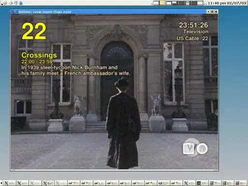

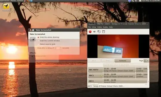

If you are absolutely sure that Bus 002 Device 051: ID 1b80:e421 Afatech is the device which refers to your TV Tuner (mine reads something like: Bus 002 Device 030: ID 2040:7240 Hauppauge WinTV HVR-850) you should say what are you doing in order to gather the TV Signal, which will be something like
MeTV
or (my favorite)
TvTtime
(Illustrations are from the net)
Answers to the question: How to scan for analog cable channels on a DVB-T USB tuner? might help.
There is also the hard procedure documented over here: Fonomo, TV Tuner and Webcam Misconfiguration inside of the Ultimate Edition Forums can give you a clue on where to begin.
Anyway as far as I can say, if your USB TV Tuner dongle is being recognized by your system and you have such a confirmation of "readiness" by a LED turned on or something (Like my case with the WinTV-HVR which turns on a blue led when the driver is ready, almost instantly), then you can go and run your favorite TV tuning software.
