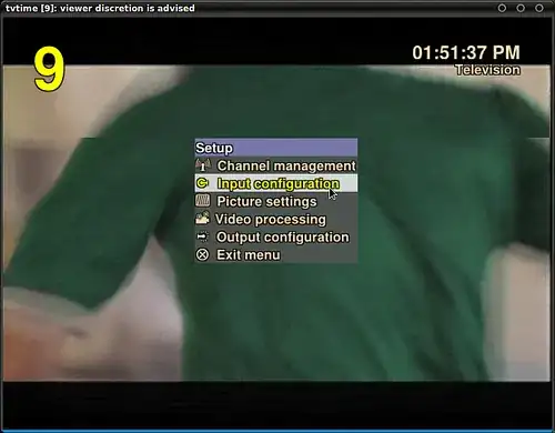

Here is the main TVTime television viewer, with the analog channel 9 playing and the menu shown (right clic for menu, left clic for OSD)
tvtime

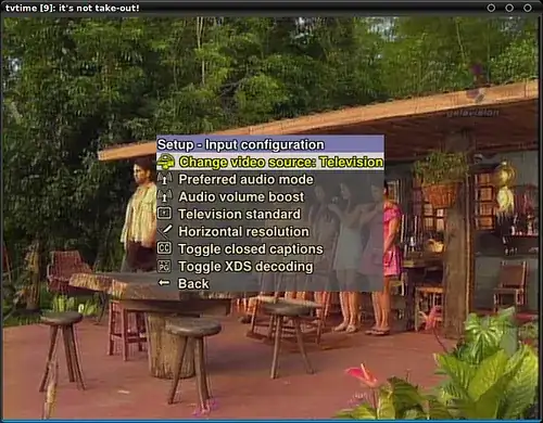

Let's hit the Input configuration option in order to set up the video source, click again and again in order to cycle between the different video sources.
http://farm6.static.flickr.com/5224/5762146917_12f3b3cc19.jpg

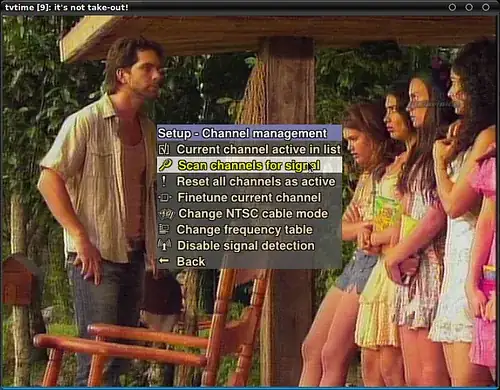

Back in the main menu, et0s choose "Channel management" and you will have the next screen, on which you may find the "Scan channels for signal", this can take a while.
http://farm4.static.flickr.com/3307/5762690574_a3cee156a8.jpg

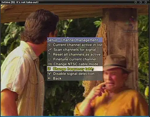

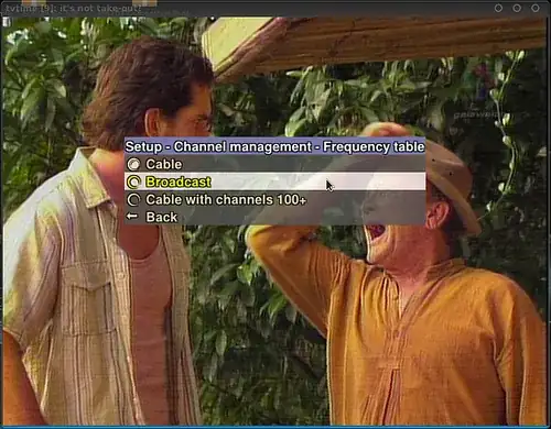

In the same section you can find the "Change frequency table", on which you can adjust where is the tuner going to gather frequencies table, this will allow you to define whether to use Cable or Broadcast systems.
http://farm4.static.flickr.com/3271/5762691258_1681607fa3.jpg
