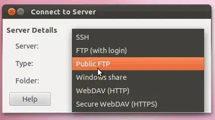

NOTE - You can also use SSH from GUI tools like filezilla which offer the option to use ssh instead of ftp. ssh can also be accessed from within the Ubuntu menu:
which gives access to several options including Windows share, SSH and FTP:

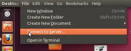

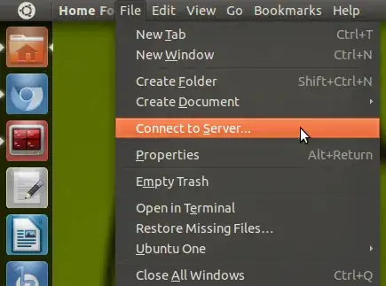

If you want to browse the server through Nautilus like you do with files on your local machine:
  1. Open Nautilus ("Home Folder")
  2. Go to "File" --> "Connect to Server"

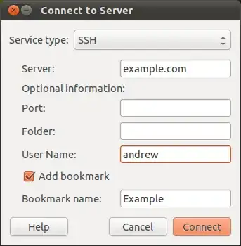

    Connect to server
  3. Select "SSH" under "Service Type"
  4. Put the IP address or domain under "Server"
    Select SSH
  5. Add your username and check "Add bookmark" if you want the location saved to your bookmarks.
