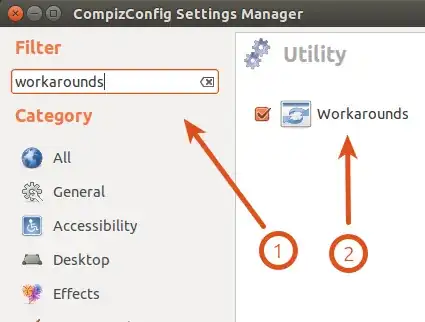

Try going into CompizConfig Settings Manager and searching for workarounds.
Click on the only result:

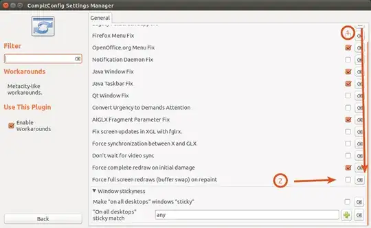

then scroll down to the bottom and select the Force full screen redraws (buffer swap) on repaint check box:
Close CompizConfig and reboot and see if this helps.
This resolved a screen flicker I was having with my NVIDIA GTX 750 Ti, so I'm not totally sure it will work, seeing as you don't give your GPU (if any.)
However, it never hurts (well, normally) to share - hope this helps :)
