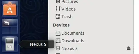

When I mount a my phone, Unity set this icon (or one like it) in its Launcher: /usr/share/icons/Humanity/devices/48/multimedia-player.svg
Nautilus shows this icon (or one like it): /usr/share/icons/gnome/scalable/devices/multimedia-player-symbolic.svg
The thing is I'm tired of looking at a silly generic multimedia player icon for my phone. I want to add my own phone icon.
