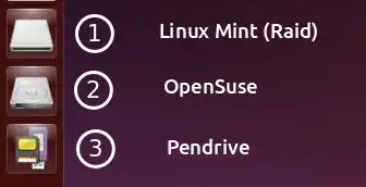

I'm running Ubuntu 13.04 and I have several hard drives in my computer and all appear with the same icon in the launcher. Is it possible to modify their icons one by one or at least change their color to better find what I'm looking for?

You can use udev rules to match with your devices and then assign an icon.
NOTE: In this example I will change the icons for 3 devices, usb pendrive, partition with Opensuse and a partition (Raid) with Linux Mint.

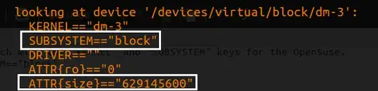

5) In case of the Linux-Mint-Raid partition, I'm goin to match the rules with the "SUBSYSTEM", "ATTR{size}" and the "ID_FS_LABEL" ENV variable.
List the attributes and variables of the Linux-Mint-Raid partition with "udevadm info -a -n device name" and "udevadm info -q all -n device name".
  • udevadm info -a -n /dev/mapper/pdc_cjjfccgf3
  • udevadm info -q all -n /dev/mapper/pdc_cjjfccgf3
