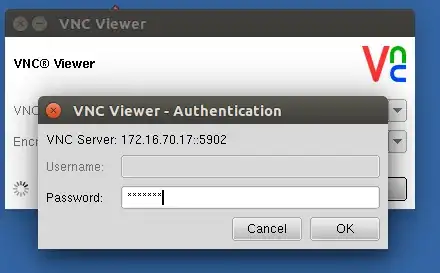

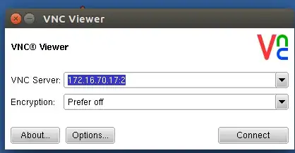

(10)download http://www.realvnc.com/download/viewer/
enter servername/ipaddress and session id for example my server is 172.16.70.17 and if i use 172.16.70.17:2 it will login to test2 user desktop.. and 172.16.70.17:3 will login to test3 user desktop like wise
make sure encryption to be selected "Prefer off"
pic
pic

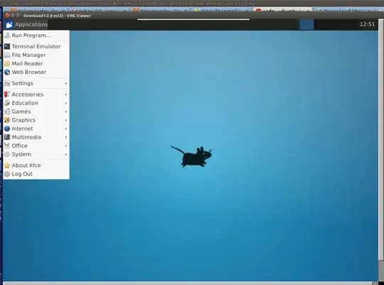

Then you can access your desktop and applications in this manner..
pic
