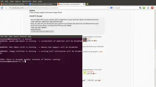

I updated my Ubuntu and while it was restarting command line appeared and froze, then I forced shutdown PC and when Ubuntu booted again, I saw unity is corrupted. Launcher and menus disappeared but Alt+Ctrl+T and Righ-Click menu works. Also I can open Firefox and other apps through terminal. This is how my current desktop:
