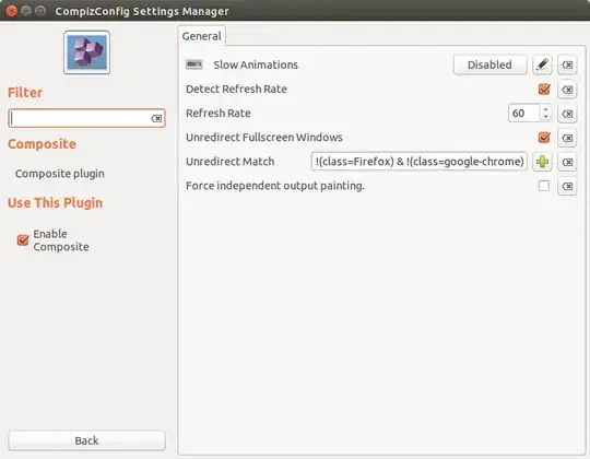

It seems like the problem reappeared with Chrome version 49. Below is a workaround that will solve the problem until Chrome fixes this bug. It works without disabling hardware acceleration in Chrome (and potentially causing other issues).
  1. If compizconfig-settings-manager is not installed, install it by
    sudo apt-get install compizconfig-settings-manager
  2. Launch compizconfig-settings-manager by typing ccsm from the terminal
  3. Double click to open the Composite plugin
  4. Add & !(class=google-chrome) at the end of the Unredirect Match text box (see screenshot below).
    Composite Plugin Window
  5. Close the settings manager.
  6. Be scared no more to click on Full Screen!
Source: https://bugs.chromium.org/p/chromium/issues/detail?id=550091#c43

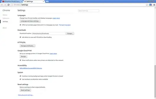

The one worked for me is this - disable the hardware acceleration settings. in google chrome. For disabling hardware acceleration - go to the option "customize and control google chrome" the gray area in upper right corner besides the option of Google input tools- Google Chrome Tool Bar
Then click on settings from the drop down menu. click on the blue option
Show advanced settings...
check for the 16th category -
System
and see if the box for using hardware acceleration is checked
system
if it is checked please uncheck it.
This has solved my problem.
