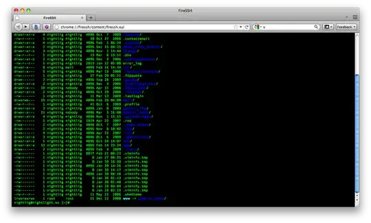

If the Library is using Firefox and has the ability to install add-ons, try FireSSH - its a javascript based SSH client.
fossfreedom

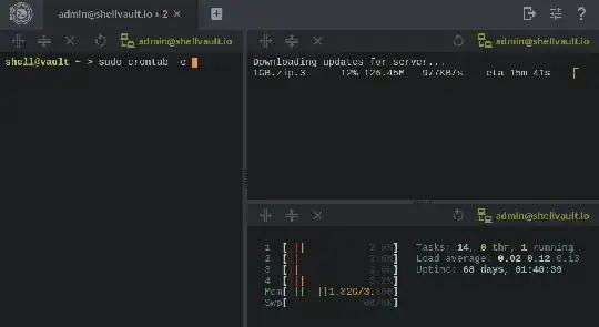

Disclaimer: I'm the primary developer for Shellvault.
Another option is Shellvault, a web-based cloud SSH client that you don't have to download or set up yourself. It has terminal multiplexing, it looks nice by default, and since it's cloud-based, you can administer your servers from any computer without setting up SSH on a new machine.
Shellvault.io terminal interface
Shellvault is a Software-as-a-Service, so it's not free, but it has free trial so you can see if you like using it. After the 7-day trial, a subscription costs $5/month.
