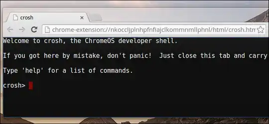

Instead of using the default Terminal emulator App, I want to open a Terminal Tab on the Chrome or Firefox Browser which I can do on Chromium OS (Crosh) but not on Ubuntu.
Crosh - The Chromium OS shell
