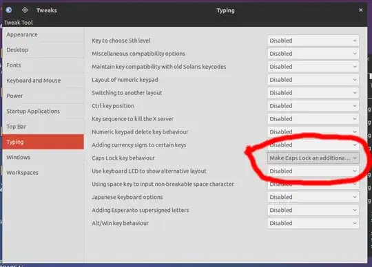

You can remap Caps Lock is by using Gnome Tweak Tool.
You can install it via the Ubuntu Software Center if you wish or by the command line; it does not come installed on Ubuntu 14.04 by default.
  1. Open a terminal by holding CTRL, ALT and T at once or by search it in the dash.
  2. Type in sudo apt-get install gnome-tweak-tool. This tells apt-get to install gnome-tweak-tool. You need to have sudo as one needs to have root permissions to install software.
  3. Open Tweak Tool
  4. Select "Typing" from the left bar.
  5. Select "Caps Lock act as shift" where it says "Caps Lock key behaviour".
Screenshot depicting step 5 above.

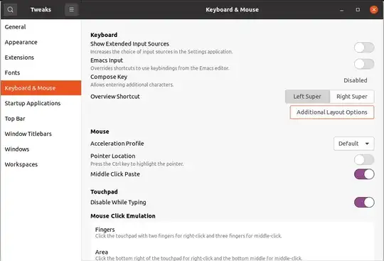

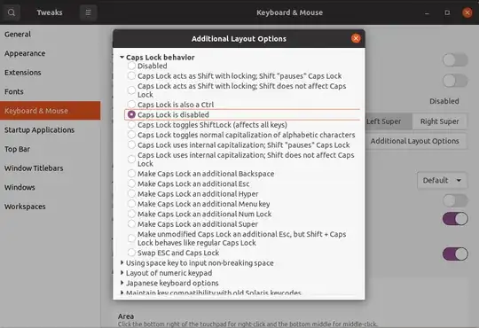

Update for version 3.32.0-1
The option is now under:
Keyboard & Mouse > Additional Layout Options > Caps Lock behaviour

for Ubuntu 17.10
sudo apt install -y gnome-tweak-tool
  1. Open Gnome Tweaks
  2. Select Keyboard & Mouse from the left panel
  3. Click on Additional Layout Options from the right side
  4. Click the arrow next to Caps Lock key behavior. Set Caps Lock key to what you want.
There are many tools out there which can get the sort of thing you want. Probably the best one for you would be Gnome Tweak Tool. To install it, run this command in Terminal:
Once it is installed:
  1. Open tweak-tool and click on the typing section in the left column.
  2. You should now see the line Caps Lock key behaviour on the left.
  3. Choose Disable from the drop-down list. And then it should disable the Caps Lock key.
