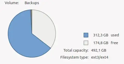

When I right click on Properties for my ext4 partition I get the following pie chart:
The meaning of the blue and white slices are fairly obvious, since they are in the legend to the right, but what does the grey slice represent? It's quite substantial and at least a couple of GB's in size.

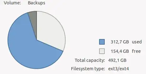

By default ext2, ext3 and ext4 reserve 5% of all space for the root user and to prevent fragmentation (see this mailing list). However as this particular disk is used for archiving data that doesn't change much, I have taken the liberty to change this percentage to 1%, using the command:
sudo tune2fs -m 1 /dev/sdb
the last item /dev/sdb reflecting the location of my disk. Behold:
reserved space on disk is reduced
