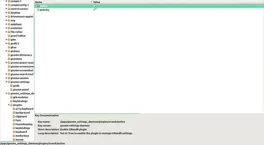

Using gconf-editor, find the following conf key:
/apps/gnome_settings_daemon/plugins/xrandr/active
and set it to false (not checked). The change should be effective immediately after the edit.
