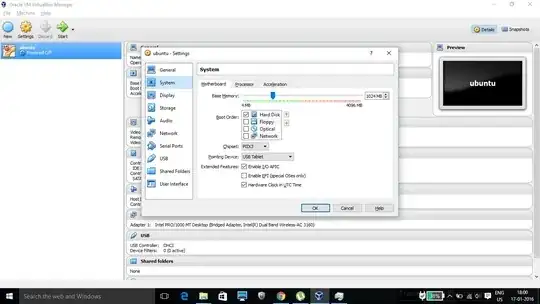

Another option is to un-check the Extended Features option called 'Enable EFI' under 'Motherboard' for your VM.
Had this issue come up for Gnome Ubuntu 12.04.2 amd64bit installation.
Discovered this after having to change settings for hardware acceleration. I was left with having VT-x/AMD-V, Nested Paging enabled. My VM has 2 CPUs, 8GB RAM for reference.
After un-checking the issue is completely by-passed Gnome Ubuntu boots up no issues. Running Virtual Box 4.3.18 r96516 on Windows 7 64-bit Host.

I recently encountered this problem. Please check your virtual OS settings. Right click on virtual os-> system->Extended features-> Enable EFI(uncheck this). enter image description here
