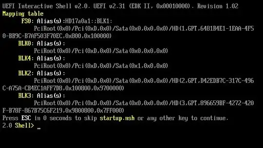

I'm using Ubuntu 14.10 on a VirtualBox VM. It installed fine, I was even able to install Guest Additions and a few apps before shutting it down for the day. Now when I try to boot the VM all that loads is the UEFI Interactive shell.
How do I get it to boot back into the normal desktop?

Edit startup.nsh. Add the line:
fs0:\path\to\grubx64.efi
