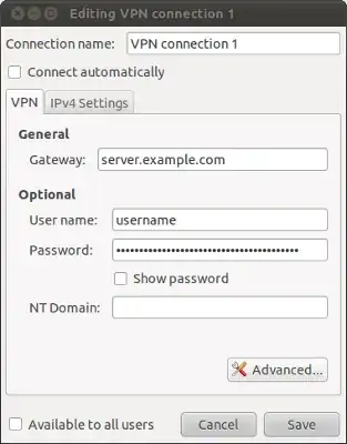

In the Network Manager applet, select VPN ConnectionsConfigure VPN, then click Add. On the next screen select PPTP for the VPN type, then click Create.
In this window, enter your server's hostname or IP along with the username and key that you added to the /etc/ppp/chap-secrets file on the server.

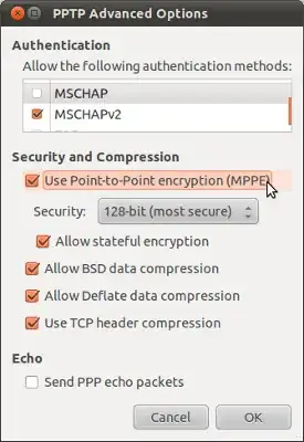

Now click Advanced.
In this window, enable "Use Point-to-Point encryption (MPPE)" and select 128-bit security. Disable the use of MSCHAP authentication (leave MSCHAPv2 enabled).
Finally, click Ok and then Save to close out the previous window.
