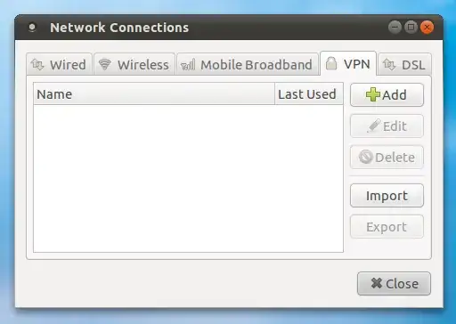

Configuring a VPN is pretty simple. Open up the Network Connections dialogue and hit the VPN tab, as below:
Network Connections jobbywhatsit
That leaves two issues:
  • You need a VPN to connect to. These are widely available but cost money. Note that some if not all of these might be blocked by China (for obvious reasons). You might need to rent your own server (eg from a company like Linode) and install your own VPN server. You could just use a Socks proxy over SSH if that's what you end up doing - Much easier and should work for most things.
