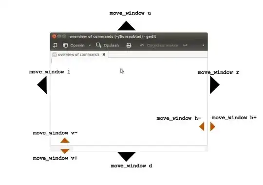

Assuming you are using Unity, the script below moves or resizes windows by 1 px. The script can be run with 8 different arguments. Depending on the move/re-size options you want to use, you can add the commands to a shortcut key combination. An overview of options and the corresponding commands below:

How to use
  • First install wmctrl, which is needed to get the window geometry and to move the window.
    sudo apt-get install wmctrl
  • Create a directory ~/bin (so in your home directory)
  • Copy the script below into an empty file, save it as move_window (no extension)
  • Make it executable (right-click on the file > Properties > Permissions (tab) , tick "allow execute")
    To test, open a terminal window and run subsequently:
    move_window l
    move_window r
    move_window u
    move_window d
    Since the terminal window is the front-most, it should move 1px to the left/right/up/down.
    (As mentioned, resizing does not work with gnome-terminal)
  • If it works correctly, add the commands to shortcut keys;
    choose: System Settings > "Keyboard" > "Shortcuts" > "Custom Shortcuts". Click the "+" and add the commands to four different shortcut key combinations. That might be tricky, since the commands you mentioned are probably occupied. What worked on my system:
    • Shift+Ctrl+arrow key left
    • Shift+Ctrl+arrow key right
    • Shift+Ctrl+arrow key up
    • Shift+Ctrl+arrow key down
    for the move actions.
    For the resize actions you'll have to try additional combinations.
