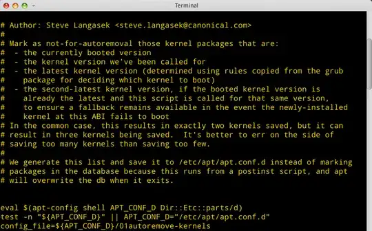

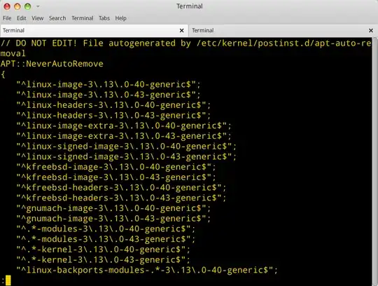

As to answer why , refer to the file /etc/apt/apt.conf.d/01autoremove-kernels
As you can see, apt is told to never autoremove the kernels , as told by another (script) file, /etc/kernel/postinst.d/apt-auto-removal. And here it is:

In the /etc/kernel/postinst.d/apt-auto-removal there is this part:
if [ "$latest_version" != "$installed_version" ] \
   || [ "$latest_version" != "$running_version" ] \
   || [ "$installed_version" != "$running_version" ]
then
        # We have at least two kernels that we have reason to think the
        # user wants, so don't save the second-newest version.
        previous_version=
fi
So if you compare the output of 01autoremove-kernels file and uname -r you'll realize that the currently running kernel and the most recent before it, are kept to be never removed by that script. There turns out is another file /etc/apt/apt.conf.d/01autoremove, where there is lines:
