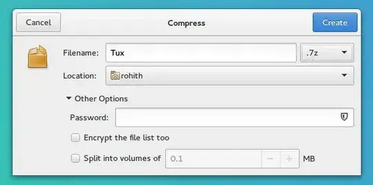

Archive Manager, or file-roller, doesn't seem to have the option to set the compression level for 7z files.

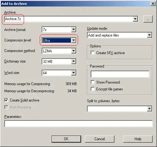

However, the windows client 7-zip has an option to do so using GUI -
On Ubuntu/Linux, one can set the compression level in the command line (CLI) using the -m flag. For details, refer to this answer.
Is there any provision for setting the compression level for 7z archives using GUI in Ubuntu?

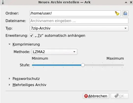

The Ubuntu community (not Canonical) do offer you ark in the universe repository.
