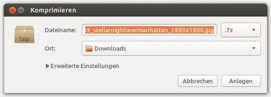

The package p7zip you installed from Software Center contains a port of the command line utility included in the 7-Zip installer for Windows. It does not include any applications with a graphical user interface (GUI) like 7ZipFM.exe. Instead, it extends the functionality of the archive and extract tool (file-roller, page in Software Center) included in the default installation.
Picture showing compress dialog with 7z set as output format. The language is German; please replace.
